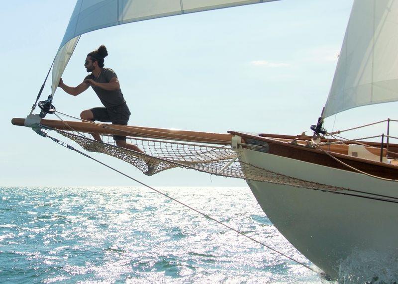

Ubi Maior Italia - The Unique Jiber Furling System © Ubi Maior
Florence-based Ubi Maior Italia are breaking boundaries with their patented Jiber Furling System a structural furling forestay system with the benefits of a traditional furling system.
