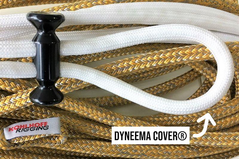

Dyneema Cover in use © Kohlhoff

Spliced as an extra cover on ropes, these properties make it useful for a host of applications onboard, for example:
  • Chafe protection on lines Protect rope eyes, rope splices and other exposed parts of ropes
  • Making your own loops and strops Use a cover to hold together multiple rounds of 1.5mm Dyneema®
  • Increasing line durability E.g. around lead blocks, sheet exits, and halyard exits
  • Reducing diameter of the original cover Original covers on ropes are not generally manufactured from pure Dyneema® and, as a result, are often thicker and designed for grip. Instead, Dyneema® is thinner, sleek and reduces friction on the running section of lines
  • Protecting the core from UV damage
  • Extending the life of a line E.g. If the cover of your halyard is chafed and worn but the core remains intact, it is possible to simply strip the damaged cover and re-cover it. If it is just the halyard exit, for example, that has been damaged, it is possible to replace just this part of the cover
