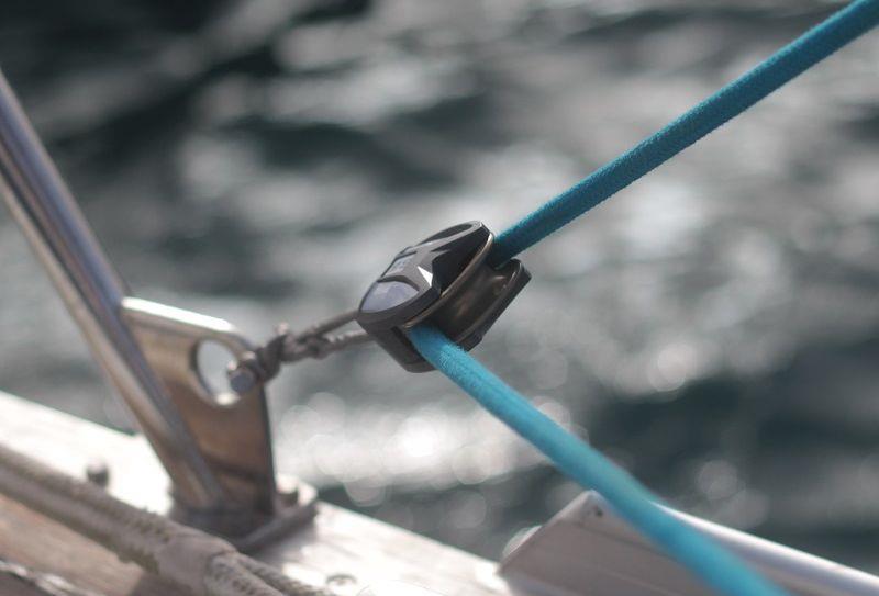

Stripped of the central metal axle, bearing and sheave found in most traditional blocks, the Ino-Block is a true composite block that instead utilises an ingenious textile axle. In a potentially revolutionary step, the load bearing elements consists of a simple aluminium sheave, running directly over a Dyneema® SK99 strop.
DAME nominated, this patented textile axle technology is both cutting edge and simple; the efficient mechanism is encased in two (non-structural) lightweight plastic cheeks, and the block is suitable for both racers and cruisers.
Many traditionalists would argue that this does not constitute a 'real block' - however, with the sheave bearing directly on the Dyneema® axle, it is, in effect, a plain bearing block which is suitable for high loads and low line speeds.
In fact, Ino-Rope claim that the greater the load the more efficient the block becomes, as the Dyneema® gets smoother. At lower loads it is less efficient, which is where ball bearing blocks will always have the advantage. So, given its weight advantage the Ino-Block looks to have a bright future in the market.
Indeed, akin to the Ino-Bock, Morf Block was launched 12 months later with a similar principle. However, the subtle difference with the Morf Block is that it utilises a physical plain bearing between the thimble and the Dyneema® loop. As a result, the manufacturer can play with the material composition of the bearing to optimize the block for high load/low speed OR low load/high speed. Read our full article on Morf Blocks.
A big advantage of both is their inherent safety: as the Dyneema® loop goes through the centre of the sheave, even if the cheeks and thimble fail completely the loaded line would be safely held by the Dyneema® loop, making catastrophic failure significantly less likely than with a traditional block.
The simplicity of the Ino-Block also means it is easy to inspect and maintain - corrosion resistant, it does not require lubricants, and the Dyneema® loop just needs checking occasionally. That's it!
