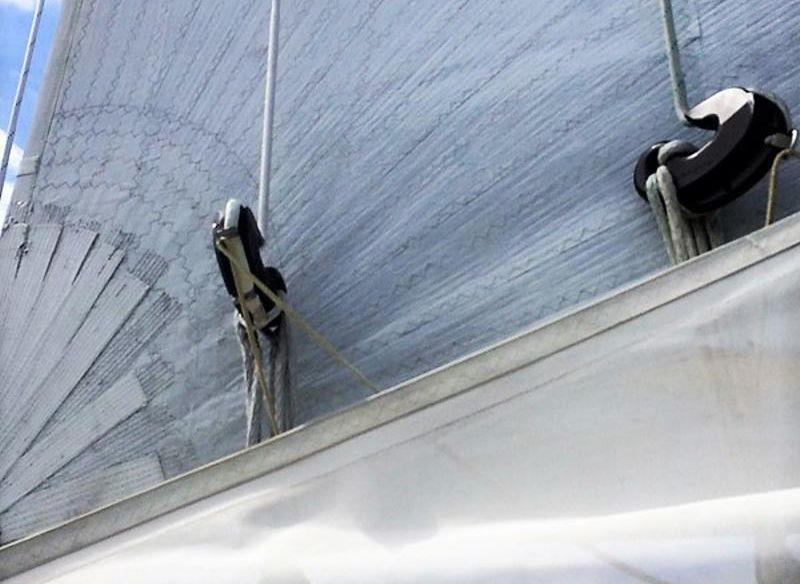

Karver Reef Hook KHR © Karver

An ingenious addition to their portfolio, Karver's KHR Reef Hook offers an unconventional way to reef your mainsail.
Originally designed for ocean racing multihulls, reef hooks are now being adopted by more and more cruising sailors, who are choosing to replace their current pennant reefing system with a hook.
So, how does it work?
A reef hook is installed close to the boom's axis with a lashing. A small diameter control line guides the hook to the mainsail reef point, where a sheathed, high load Dyneema strop is sewn into the sail. This control line is used to draw the sail loop to the hook where it automatically locks into place.
On the boom, another release line is used to unhook the KHR. Both lines can be operated remotely - from the cockpit or mast step.
To activate the Karver KHR reef hook, simply haul down on the mainsail to get the reef point close to the hook. Pull the hooking control line to guide the hook inside the Dyneema strop and haul the mainsail back up again.
To unhook the Karver KHR reef lock, again ease down on the mainsail - whilst pulling the release line to get the hook out of the loop, and then haul up the mainsail again.
Each reef point on the main sail should have its own hook; it is advisable to rig each hook with a tight lashing or to protect it with neoprene to prevent impact on the boom.
