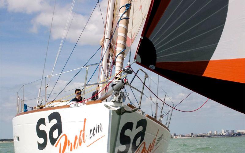

What is a top down adapter? How does this work when furling? © Facnor
The top-down adapter, also known as a tack swivel, is an increasingly popular evolution of the top-down furling system. This technique provides cruisers and racers alike, simplicity, safety and speed for the handling of loose luff sails such as asymmetric spinnakers and gennakers.
Cruisers can store, deploy and retrieve these sails, as they would a furling head sail, from the safety and convenience of the cockpit. Whilst racers are increasingly using top-down as a super-fast and efficient retrieval system for both code zeros and asymmetrics. For more information on top-down versus bottom-up furling check out our blog
