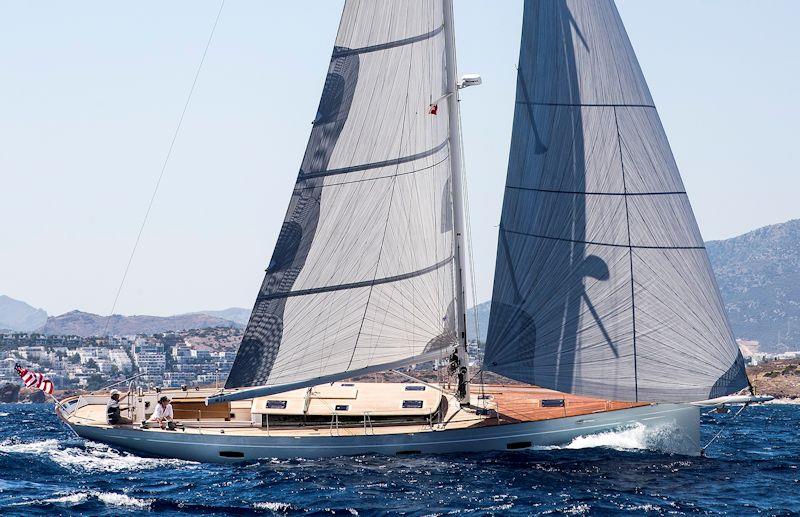

Calculating your sail area is often required when selecting new hardware © Facnor
