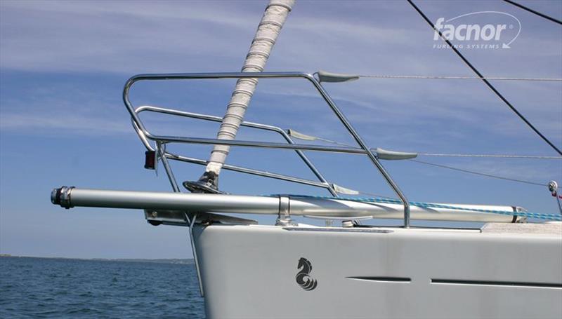

It is a straight section alloy tube. It is retained in an articulating collar at the bow and the tube can slide forwards and backwards through this collar. When the tube is retracted, the back of the tube is placed on a "parking" fitting so that the front of the sprit is sitting at the bow in the collar. This makes it very convenient to attach/remove the furling unit to/from the front of the sprit. The tube can also easily be removed from the collar and stored along the guardrail when not in use, which leaves the foredeck completely free.
When you want to use the furling gear, the quick release fitting at the aft end of the tube is released from the parking fitting and pushed forward to a "working fitting". The Forward deck fitting (supporting the collar) and the aft working fitting must take all the forces applied to the bowsprit, by the loaded sail, and therefore must be placed in a structurally sound area of the deck. This is generally not a problem at the bow but it is a consideration for suitable placement of the aft fitting.

The one main obstacle for this type of sprit is the bow configuration. By definition, there is generally not much room at "the pointy end" and it can be a problem to find a clear path for the bowsprit tube, through the bow area.
The forward deck fitting and collar need to be as far forward as possible but this will be limited by space available for the fitting and accessibility under-deck to tighten the bolts. The biggest problem, however, is usually related to anchor gear which obstructs the path of the tube through the bow area. It is sometime possible to do a custom installation over the anchor rollers (as in the image above) but this quickly escalates the complexity of the job and should be the first item on the checklist to assess the suitability for this type of bowsprit.
