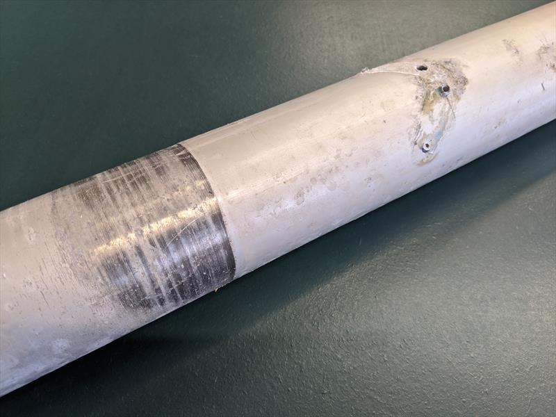

Signs of aluminium mast wear: Laser mast bottom-section with deck rubbing and kicker fitting corrosion © Mark Jardine

"The shrouds are the highest loaded point on the mast, followed by the forestay. Check for signs of corrosion on anything between stainless steel and aluminium - as you can see on this mast, there is a lot of cracking appearing around the hole the shroud goes in - this will only get worse and eventually the crack will go all the way around the mast and meet the other side which is also starting to crack. This is all due to the corrosion between the aluminium and stainless-steel fittings. The T-terminal needs taking out, the corrosion cleaning up and then a new anti-corrosive compound needs putting in there, such as Duralac or Tef-Gel and the fitting put back on. This particular mast is already starting to crack though and it's only going to get worse."

"As with other points, check for corrosion between the stainless gooseneck fitting and the aluminium of the mast. This one looks ok, but we are starting to see white bubbling around the edges where the aluminium is beginning to corrode. The fitting needs taking off, cleaning up, anti-corrosive compound applied and then fitted back onto the mast."

"We have a block which we can see has been moved three or four times and has pulled out because of the corrosion underneath. These should be 5mm holes and they're now massive."
