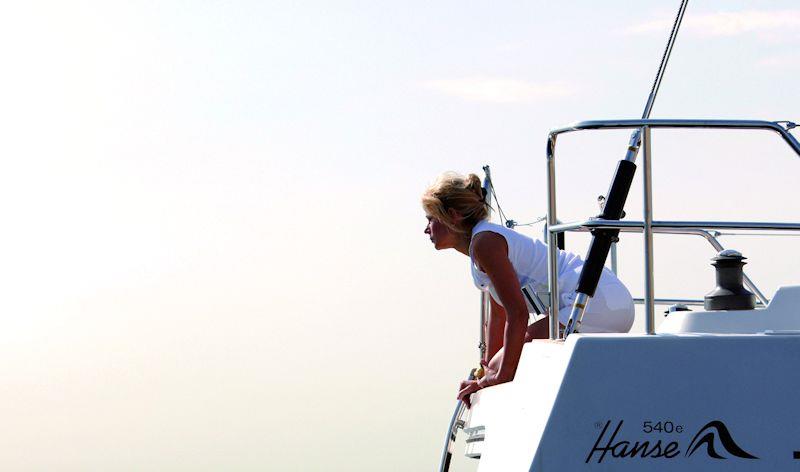

Bamar BTM backstay tensioner © Bamar

The Bamar BTM mechanical tensioner, on the other hand, is a very "grown-up" piece of kit which is most commonly seen on fixed backstays but can also be used for adjustable inner forestays (with quick release pins which come as an option). Designed to be used with any standard winch handle, this is a neat, low profile, reliable mechanical adjuster which is simple to operate and maintain.
A nice feature is that the winch handle clutch can also be rotated around the BTM body to allow you to have the handle protruding from whichever angle is most convenient. The body is made of a black Hardcote anodized aluminium with stainless steel parts.
