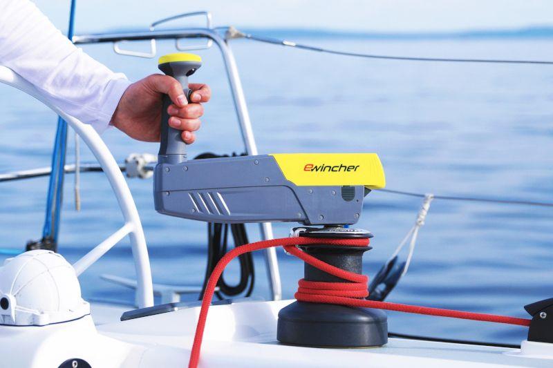

The Ewincher is a power-assisted winch handle that can be used for either fully electric winching, assisted winching, or as a regular winch handle, depending on the level of assistance required.

While the Ewincher is 355mm in overall length, it still maintains the circumference of a standard 10" winch handle (254mm). So, if your standard winch handle fits your restricted deck layout, the Ewincher will too.
Ewincher has a highly efficient 25V lithium-ion battery with a battery life capable of hoisting the main sail 3 times and tacking 35 - 40 times on a 40ft boat. Ewincher do recommend a spare battery for boats over 40ft, but these can be swapped out in seconds. It also only takes 90 minutes to recharge on 12v or 24v supply.
