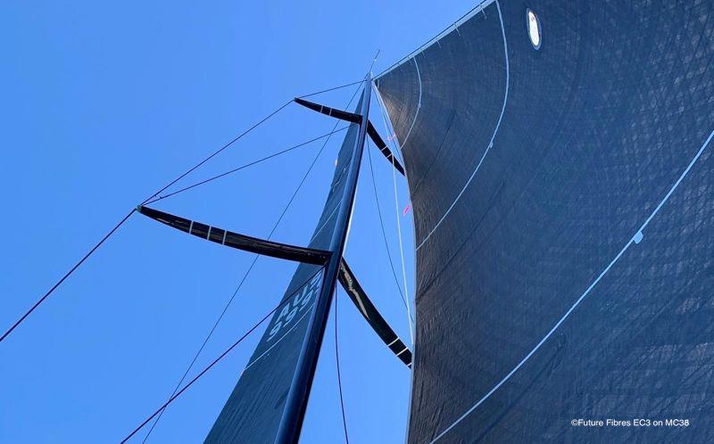

Composite rigging benefits © Future Fibres
Upffront.com is constantly striving for lighter, faster and safer sailing for all boat owners, regardless of sailing style. Composite (or synthetic) rigging is one of the biggest and most cost-effective performance improvements that you can make. In this article we look at the benefits of switching from wire or rod to composite standing rigging.
