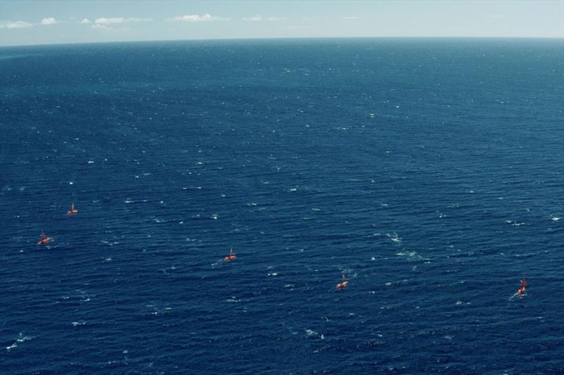

Saildrone is seeking impact partners to operationalize its USV platform for the benefit of humankind © Saildrone

Saildrone proposes a global fleet of 40 vehicles to collect carbon data for sustained monitoring. Saildrone's USVs are environmentally friendly, using wind power for propulsion and solar power to run the onboard sensors, computers, and satellite and navigation instruments. In addition to carbon data, each Saildrone autonomous vehicle collects nearly two dozen meteorological and oceanographic metrics above and below the sea surface at a frequency of 1 minute or greater.
