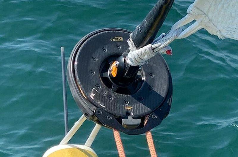

Carbon / Kevlar wheel
This is a fundamental design change and is standard across the whole range. Made from Carbon with Kevlar teeth, to provide extra grip on the furling line, this new wheel is significantly lighter than the previous aluminium wheel. However, the overall, all-up drum weight is similar to the previous V2 range because the Karver design team chose to use this weight advantage to make improvements in robustness and reliability in other areas.

The default drum material is the same as on previous models, because it has been found to be incredibly durable. However, the KFR Race line now comes with a carbon drum as standard and the KFC Classic range can have a wood veneer applied to the upper surface of the wheel to help blend in with the classic yacht aesthetic. Veneers are available in a range of different wood finishes.
