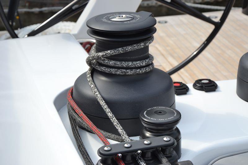

XT Cruise (Self-Tailing)
The XT Cruise is Antal's self-tailing (ST) offering for cruisers. With spring-loaded jaws, the ST system automatically adapts to a wide range of rope diameters. To protect the ST arm and avoid excess force, the line is automatically released if overloading occurs.
The task of maintenance and cleaning is simple, due to the upper ring which can be easily unscrewed to dismantle the winch. The base - CNC machined, thus lighter and stronger than normal castings - is also easily removed for maintenance.
The XT Cruise drum is available in two finishes: hard black aluminium (anodised, scratch-proof and hard-wearing) or chrome (highly polished, thickly nickel-plated and finished in chrome).
Models with an aluminium drum also benefit from a differentiated grip: minimum friction on the lower part of the drum, where loads are higher, and maximum friction on the top, where loads are minimal. This gives an even grip across the whole drum and minimises rope wear.

XT Race (Self-Tailing)
The XT Race series is derived from the XT Cruise, and thus benefits from the same design advantages. Yet, significant effort has been made to reduce the weight on the XT Race, with weight savings made through the addition of an aluminium stem, resin roller bearings in the drum plus lightened gears and main shaft. The XT Race is available in black aluminium only.
